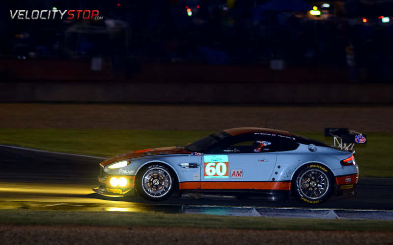

D7000, Nikkor 105mm f/2 DC @ f/2, 1/250, ISO 1000, SB-700 w/ Gary Fong PowerSnoot
edited in LightroomI took this one at the Petit Le Mans at Road Atlanta back in October. It was completely dark outside and the lighting at the track certainly didn't help photography.
Wide open aperture, high ISO, and a flash can help. I had no problem reaching the cars with the PowerSnoot on the flash (I would have had a problem without it or something else similar). The main thing I did not like about the flash was that it stopped the motion of the wheels. I think with a slower shutter speed and rear curtain flash, you should be able to keep some motion in the shot so the car does not look parked on the track. A 70-200mm lens would help a lot. I had a 105mm DC and a 55-200mm... neither a great option for racecars in the dark. I know a lot more about flash photography now than I did then and probably could have gotten a much better shot using different settings even with the same camera/lens/flash setup (I should have used rear curtain flash, a slower shutter speed, and possibly turned the ISO up a little more).
Focus should be set on AF-C, single point. Begin tracking the car with the shutter half pressed just as soon as you can see it (focus on a racecar in the dark is not fast, so give it as much time as possible).
