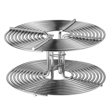

Someone once said something along the lines of "Forget the decisive moment, the hardest part of photography is getting the damn film on the reel" (I think it was John Szarkowski), and there is a little bit of truth to that, as you have discovered.
My favored method to get the film on the reel is not rewind the film all the way, but to leave a bit of leader sticking out. Then, with the lights on I start winding part of the film onto my reel (I use the Patterson). This way I know that the film is latching on properly and isn't getting folded. I then turn out the lights and wind the rest of the film on. Fogging the film doesn't matter to me since the amount I use already starts out fogged. And besides, I don't like contact printing more than 35 exposures at once so I normally intentionally waste a few frames of the roll (even though I load film in a dark room).
