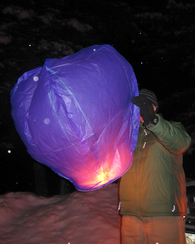

  8. Nivakon
    Posts: 72
    6ed8be6c918d73bd43169491
    sth like that. shadow lighten, the sky is much darker than what it seems on the photo

    If the lanterns are close (within you strobe's range) I would definitely play with fill and REAR CURTAIN sync. Biggest duckup you can make is front curtain sync on your fill in this situation. See how in Nivakon's example the man holding the lantern blends into the background? Unless you have a natural rim light you need to put enough low-aimed fill on the foreground subject to differentiate him from the inky background. Look for those natural rim lights.

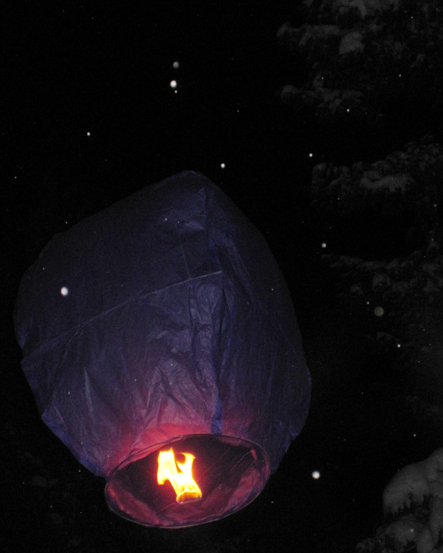

  17. Mike Gunter
    This is me on New Year's Eve with my lantern and launch.
    It was close to -20 degrees F. Another 20 degrees and both F and C are the same.
    Good times.
