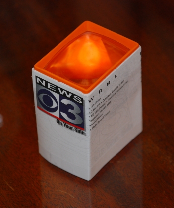

    I needed an LCD magnifier/shade for my D80 and the Hoodman seemed kinda pricey (as well as a bit delicate, according to some reviews), so being the cheapskate that I am I cobbled one together from an old Coastar 35mm slide viewer. I held the viewer and a ruler up to the camera's LCD so I could get a measurement of the focus distance, then just built a skirt of the proper depth out of many layers of shipping labels, It has functioned quite well for the last couple of years and after knocking around in my camera bag it's proved to be more durable than it looks.
